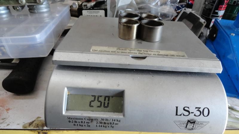

My old steel pistons(all four from on caliper) weighed in at 250 grams...
The Suzuki B-King aluminum pistons weighed in at 84 grams.

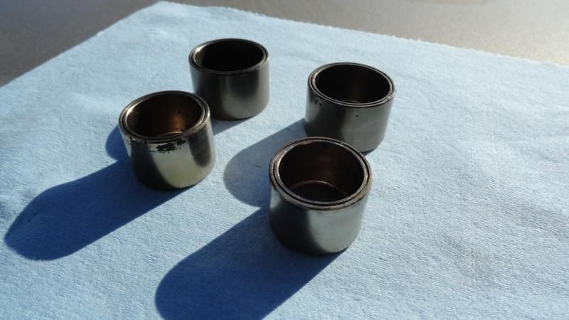

My old corroded/pitted steel pistons...

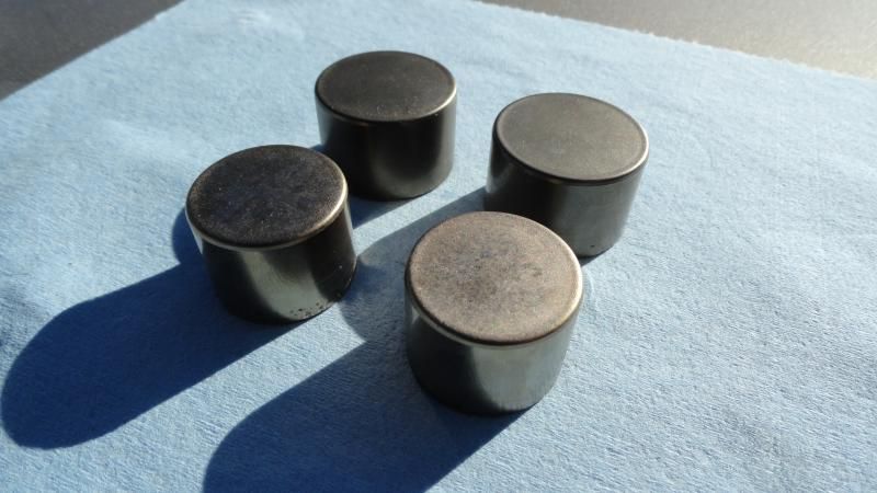

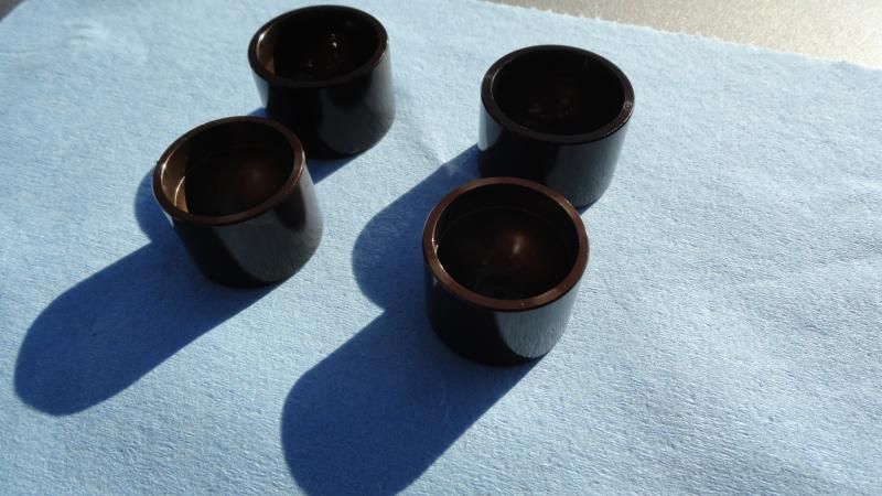

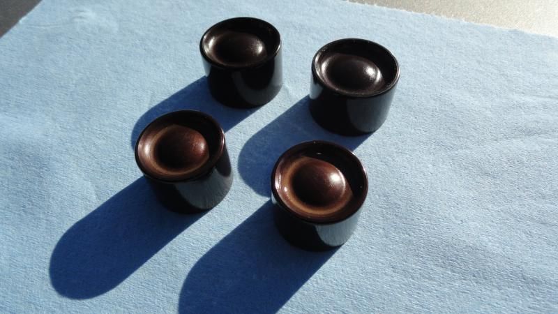

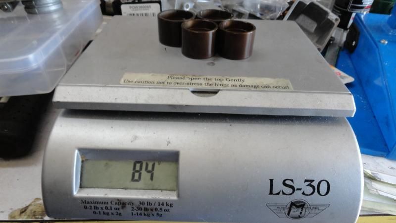

...and the new Suzuki B-King aluminum pistons.

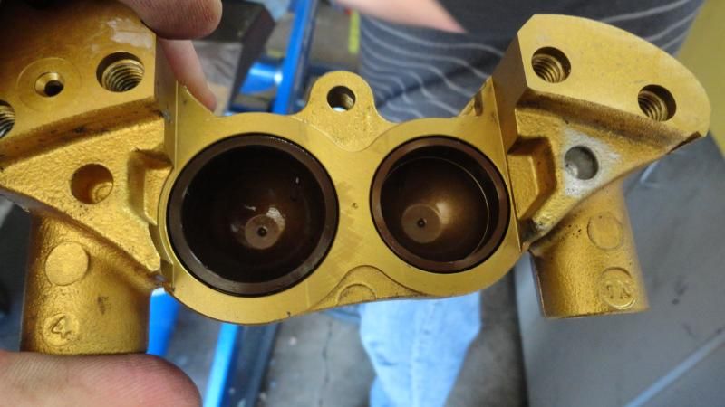

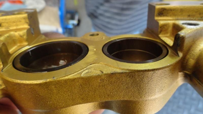

Here they are mounted in on half of the caliper...
