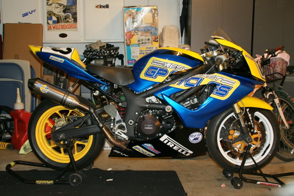

As a bigger guy on a small bike, I've had to become very adept at out-braking as well. If you take a look at mine, you'll see I've got just about the same set up... Brembo RCS 19, custom brake lines and R6 rotors. And I've replaced the EBC rotors with some Brembos. The R6 calipers are not only lighter and stiffer than the GSX-R calipers, but their a bit smaller too. So they allow me to slip 320mm rotors on my 16.5" mag. wheel.
I've got my bike down to about 330lbs with enough fuel for a sprint race. Now, if I can only get my fat ass to lose some weight, I'd be set!
