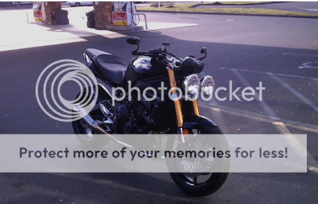

Found this pic on my phone from my ride today. Any chance to whore out pics my bike:whistle:
Thanks! Yours too. That must be a Sargent seat, it looks like? DO WANT. And it looks like you have aftermarket headlights; what did you go with? Major improvement? With the change in weather comes freaking dark at 5PM, so I'm noticing much more how shitty the Streety's stock lights are. Wondering what to do about them.

Thanks. You are correct. That's a Sargent seat. Definitely worth the investment. The bulbs are aftermarket. They're PIAA xtreme white anti-vibration bulbs. I think they made a bit of a difference. The biggest difference I had for night riding was to loosen the headlamp mount and turn the lamps up a few degrees. From the factory they're pointed at the ground 5 feet in front of the bike..which sucks.
Bulbs here:
Amazon.com: PIAA 70856 H4 Xtreme White Antivibration 60/55 Watt = 110/100 Watt Bulb - Pair: Automotive
Excellent, thanks for the link. If you don't mind a couple quick questions: easy to install? And you still have high and low beams?
You are quite right about the angling. I actually just did that two nights ago, and it's a world of difference. Not enough, though. Too many freaking deer in DC, and I want to see them way before I get there!

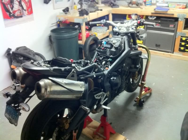

Started the winter tear down.
Chain and Sprockets
Regulator/Rectifier
New Pedals
A Serious Bath
Coolant Flush
Valve Check
Woodcraft Case Covers
Woodcraft Slider Pucks
Instal Grips
Spark Plugs
Air Filter
CRM Low Boy
Battery
What ever else I find...
Chain and Sprockets
Regulator/Rectifier
New Pedals
A Serious Bath
Coolant Flush
Valve Check
Instal Grips
Spark Plugs
Air Filter
CRM Low Boy
Battery
Thats quite a list!
good luck!
tnr
They're extremely easy to install. All you need is a screwdriver.
Unplug the battery. Loosen the screw at the bottom of the headlight bowl, take the casing ring off. Then the glass lens comes off. Unplug the OEM bulb, plug in the new one. Button it up and you're halfway there.
Yes the hi/low beams are retained.
I think the new bulbs made a pretty nice difference...but, the whole lighting system on our bike still sucks.

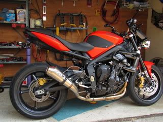

I just switched to the 3-1 Arrow after having the Arrow slipons for about 3k miles. The 3-1 feels great in comparison, stronger in the midrange. Bike looks a lot different too without all that under the subframe. If you're doing the install yourself FYI you'll have to lift off the tank completely and then pull the top two bolts on the subframe to swing the subframe up about 2". The exhaust pipe that comes through the swingarm and splits for the underseats is just long enough where it won't come out unless you cut the exhaust or move the subframe for clearance.
Just got my Arrow Lowboy installed/mapped on Saturday while the bike was in for it's 500 mile service. Man, this pipe sounds great. The growl it emits is wonderful, pure music.
The Arrow map/injection is very good, this bike fuels beautifully, damn near perfect. The bike seemingly accelerates a lil' snappier too, can't wait to start reving this baby.
I feel the weight loss as well, bike transitions easier now (not that it was bad stock). I weighed the stock system, 26 lbs 7 ounces. I did not weigh the Arrow but the shipping box label read 17.1 lbs. So there's nothing less than about a 10 pound weigh savings. Does that sound about right?
