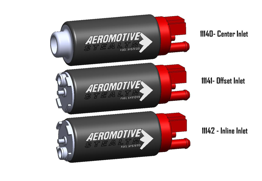

A company called Aeromotive makes a "Stealth" 340 LPH fuel pump that will also fit our bikes. This is the biggest, baddest fuel pump you can get that is a direct replacement for the stock piece.
Here's a picture of the Aeromotive Stealth 340 LPH pump:
Granted, there are a few little differences between some of these pumps, as evidenced in the following picture: Stock pumps, walbro pumps, and Aeromotive pumps can come in any of the 3 configurations depending on the OEM application:
Here's the last picture, I promise: This is a stock fuel pump in a side by side comparison to the Aeromotive stealth 340 LPH pump.
