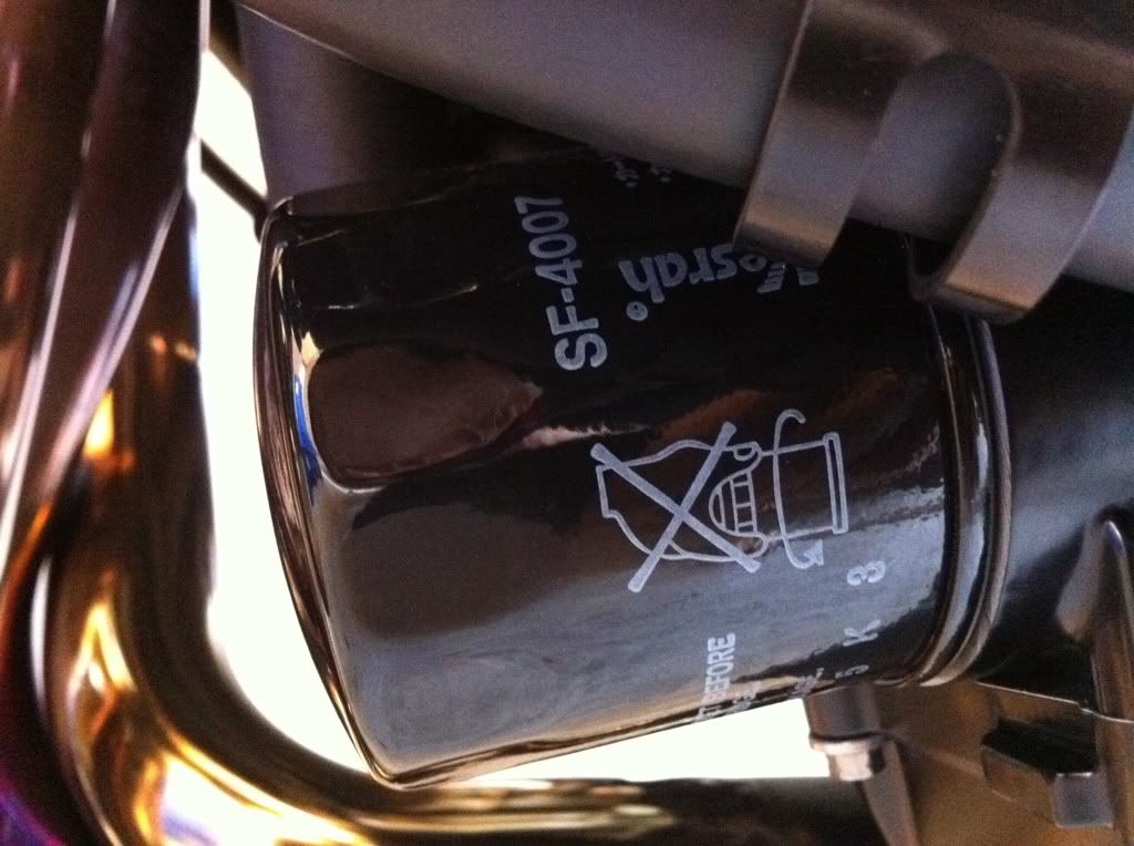

Not sure if it has been discussed before but you can use a Vesrah SF-4007 oil filter ($8), its identical to the Triumph OEM one and about $5 cheaper then Triumphs OEM.
According to K&N site, the KN-204 filter fits almost any bike you can think made in the last 10+ years.
http://www.knfilters.com/search/applications.aspx?Prod=KN-204
So there must be something in common with all bikes, so just find whatever fits those and you should be good.
As for me spending $14.95 on a K&N is fine.
