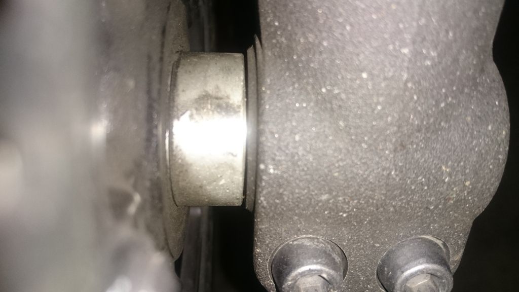

OK, so I have installed the forks... however I've run into an issue.
When tightening the spindle nut, I noticed that it bottomed out fairly far in and there was still about a 1mm gap between the wheel spacer and the fork. After some research, I found that the Daytona and the Street Triple R both have a different internal wheel spacer in the front wheel! I don't know the size, but I'm thinking this must be my problem, so the front wheels between the non-R and the R/Daytona are not compatible. I'm thinking even if I try to swap the internal wheel spacer, the groves for the bearings must be different to accommodate the internal spacer...
Does anyone have any input or recommendations? Could I compensate with slightly larger external wheel spacers (I'm not even sure where to get the ones I'd need)?

Mine looks the same ... The gurus over here please feel free to correct me if I'm wrong, but honestly I don't see it as an issue that will cause you any trouble. But don't take my word for it of course.
Could anyone with a 13+ STR upload photos of the same parts for comparison ?

My daytona looks identical to that. There was always a gap but its not really a gap it just looks like one. Take the calipers off and spin the wheel, youll know pretty quickly if something is wrong.
http://www.triumph675.net/forum/showthread.php?t=40599
Interesting! So maybe I have over-reacted. I did re-attach my standard ST forks back onto the wheel and spindle and there was no gap.
I'm still somewhat interested in this. I don't think there should be much of a gap. When the spindle is tightened down, the spindle head pushes against the spacer closest to the head. That does secure the wheel and prevent it from moving side to side, however I think that has to mean that the wheel is not centered between the forks. That gap would have to exist equally between both sides for the front wheel to be centered between the forks.
I think the most important factor is that the front wheel is in-line with the rear wheel, but I'm not an engineer and don't know important it is for the wheel to be centered between the two forks. From what I'm reading here, I'm starting to think it's not as important as I originally though. Maybe the front wheel being out of alignment to the rear by .85mm (1.7mm gap / 2) isn't a big deal. The more I think about it the more crazy I sound!!

At this point I'm having the wheel spacers done anyhow. That will help close the gap and make the wheel centered between the forks and ultimately centered with the rear wheel. Although the offset probably isn't a big deal and it would ride fine, I've come far enough that I've decided having the wheel more evenly between the forks can't hurt.
