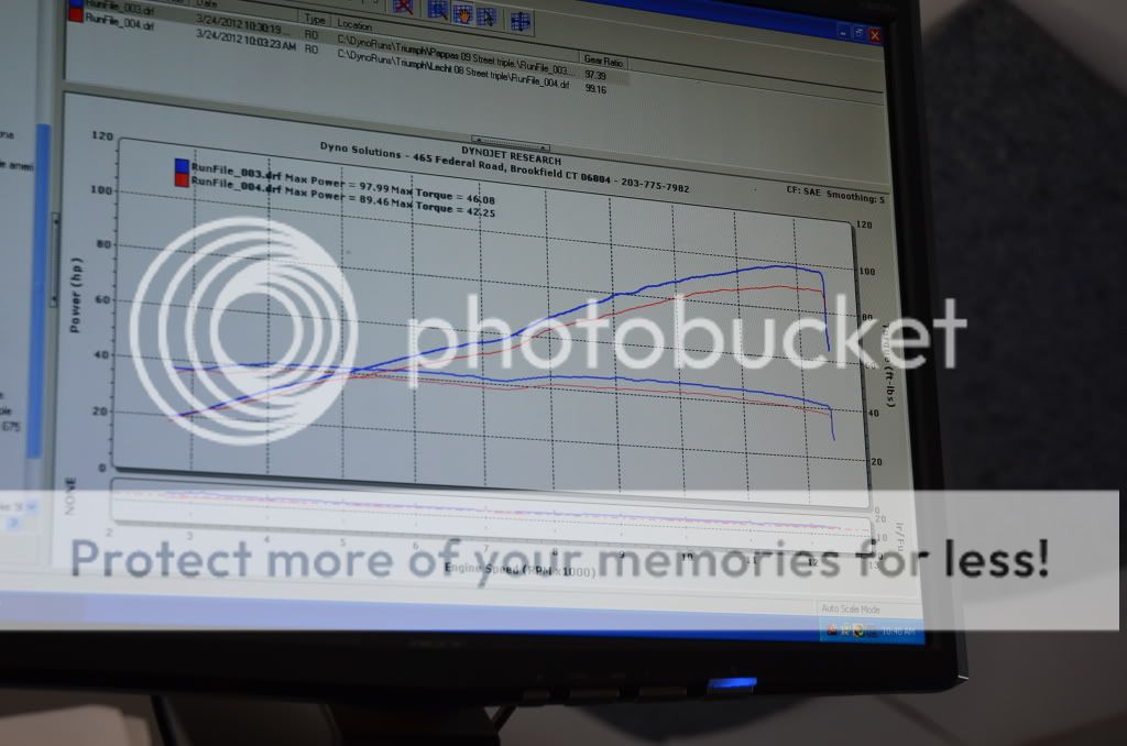

And for all you wondering what the difference between the Arrow Slip-on setup vs. the Lowboy, here it is. This is corrected. Uncorrected I was at 102, his peak was 92.
Red:08 Street, 14k miles. Arrow Slip ons
Blue: 09 Street, 11k miles, Arrow Lowboy
