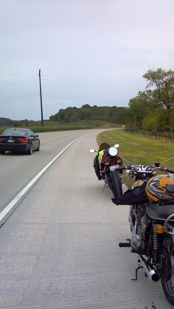

Well we get down the road and i see in my rear view my dad begins to slow down..... I am not liking this. I pull over and see what is up. He explains that the engine would just rev while he was in gear. We **** the bike down and check for gears. Click down to 1. Push bike to see if in gear, it keeps rolling. Click up to 2, it keeps rolling. Now i am getting concerned. Did i just blow the transmission by push starting....but how did it get that way after we had just rode it for 50 miles...?
so here we are stuck in between Oregon IL and Byron IL on Route 2.
The sad thing is not one person stopped to make sure we were ok. even guys with empty trailers just kept on going. I saw like 4 of those and i was like man if they could get us to Byron (5.4 miles North) or Oregon (3.2 miles south). I digress.

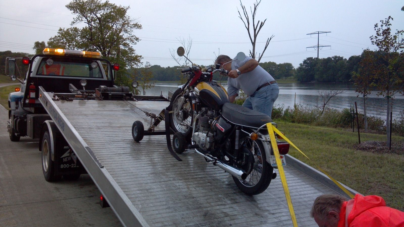

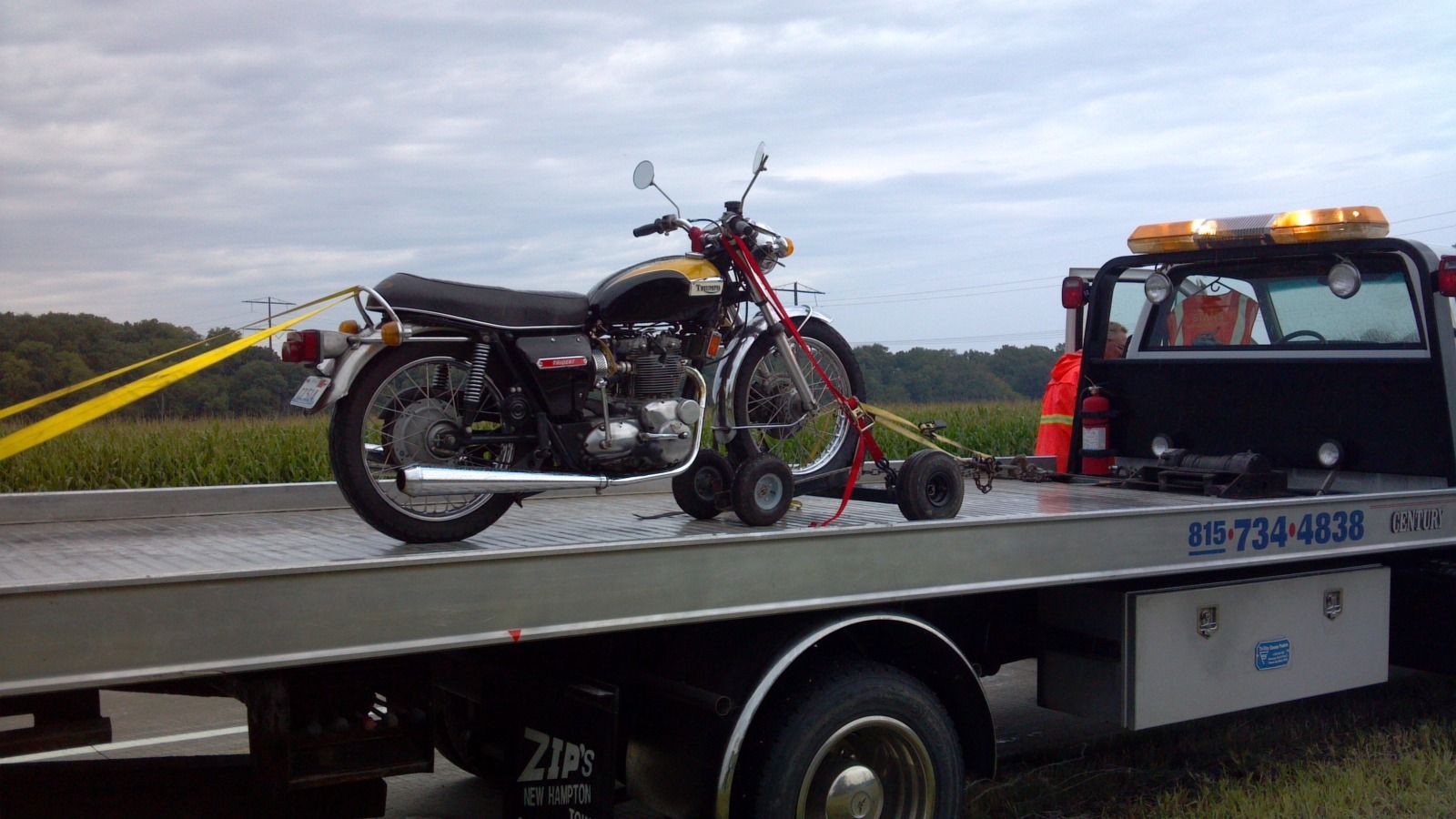

well, as you have already guessed it we had to tow the bike home.
Stan, the truck driver had a nice set up for the bike.

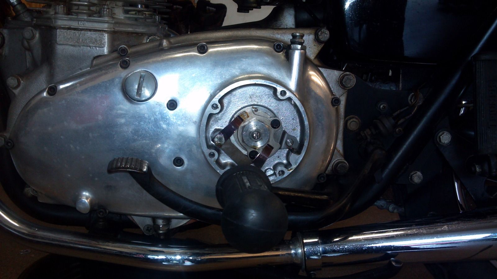

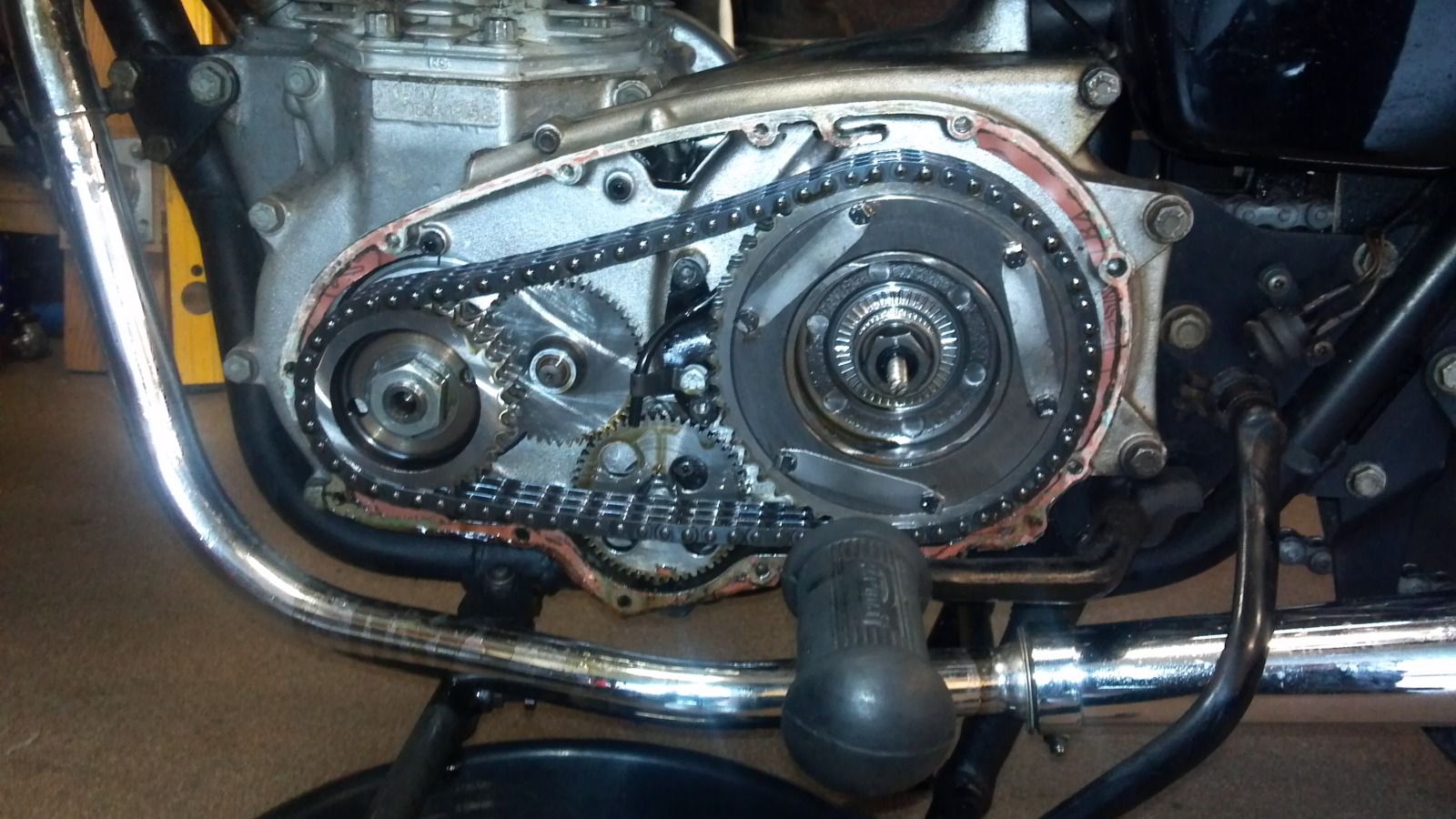

#8 ·
started taking things off the bike.
I was inspecting everything on the primary side and did not see anything out of the ordinary. no metal shavings, no sludge build up, so i am thinking this is great.
I then said to myself, how about i just try and see if there is anything at the kick arm. I try to push it down and i was amazed that there was something there. I put the bike into gear and tried rolling the rear tire, would not go forward. Seems as if all the symptoms had disappeared. This was on a cold engine, i was getting problems when the bike was hot....
I also drained all the oil out and did not see anything out of the ordinary. Next step is to take primary side off and inspect clutch....
That is for another this weekend, which i have off.
Thanks for the support. :thumbup:
Joe
