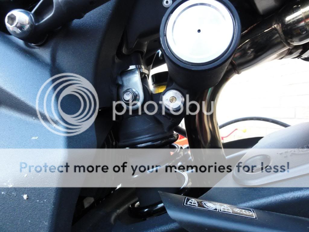

First off, thanks to the OP for the all the info.
I threw a '07 CBR600RR shock in my '10 Street Triple this weekend. As many are saying, it's an incredible upgrade. And the bang for your buck is out of this world (you can thank squids for totaling all of their bikes on their first fast corner)
I took off my exhaust and removed the subframe tray so I could work in a clean and clear fashion. Didn't want to get sloppy with such a critical aspect of the bike. There's alot of info out there as to the exact measurements of shimming required for the CBR shock. I had much different results, but it's perfect and rock solid, so I advise that you do your own work instead of relying on someone else's data there. You'll need to suspend the bike to take the weight off the rear. I just used ratcheted tie downs hooked onto the subframe and hung from the support beams in the shop.
Long story short, your'e just taking up the slack with steel washers (not aluminum) and you'll have to extend the distance of the drop plate links to accommodate the wider bottom end of the Honda shock. This is where most of your time will be spent shimming. You'll want the distance at all three points to be the same so the load is being dispersed evenly (I recommend using a digital caliper), otherwise you'll opening the possibility of stressing one area more than another, leading to a failure.
Make sure the three bolts you get are the "fine" 1.25 pitch thread, which will also disperse the needed 48nm (35ft lb) of torque properly. I threw a little blue loctite on for safety's sake, which'll add approx 15ft lbs without any extra stress on the bolt threads. I couldn't find any M10 1.25 in 60 or 65mm so I just cut down and shaped 80mm's.
All that said, once you pluck the stock shock out, you really realize how much of a budget component it was. The new ride feels so much more planted and stable. Puts down power very well and absorbs all the roads imperfections wonderfully. It'll increase the ride height quite a bit in the rear from stock as well, so you'll have a sharper turn-in too. You'll also notice that the bike leans over more on the kickstand afterwards.
For anyone interested in doing the same, I highly recommend it as the one of the first mods to do. Replacing the bike's weakest, critical component. Below is a link to the Honda's recommended stock settings from the owner's manual so you have a base point. 2007 Honda CBR600RR Rear Suspension (Owners Manual) PDF
Here's my settings for 170lbs w/ gear, which gave me a perfect 30mm SAG.
Preload: 4 of 7
Rebound Damping: 1/2 turn out from full stiff
Comp Damping: 6 clicks out from full stiff
Pic of the shock freshly mounted and torqued in.

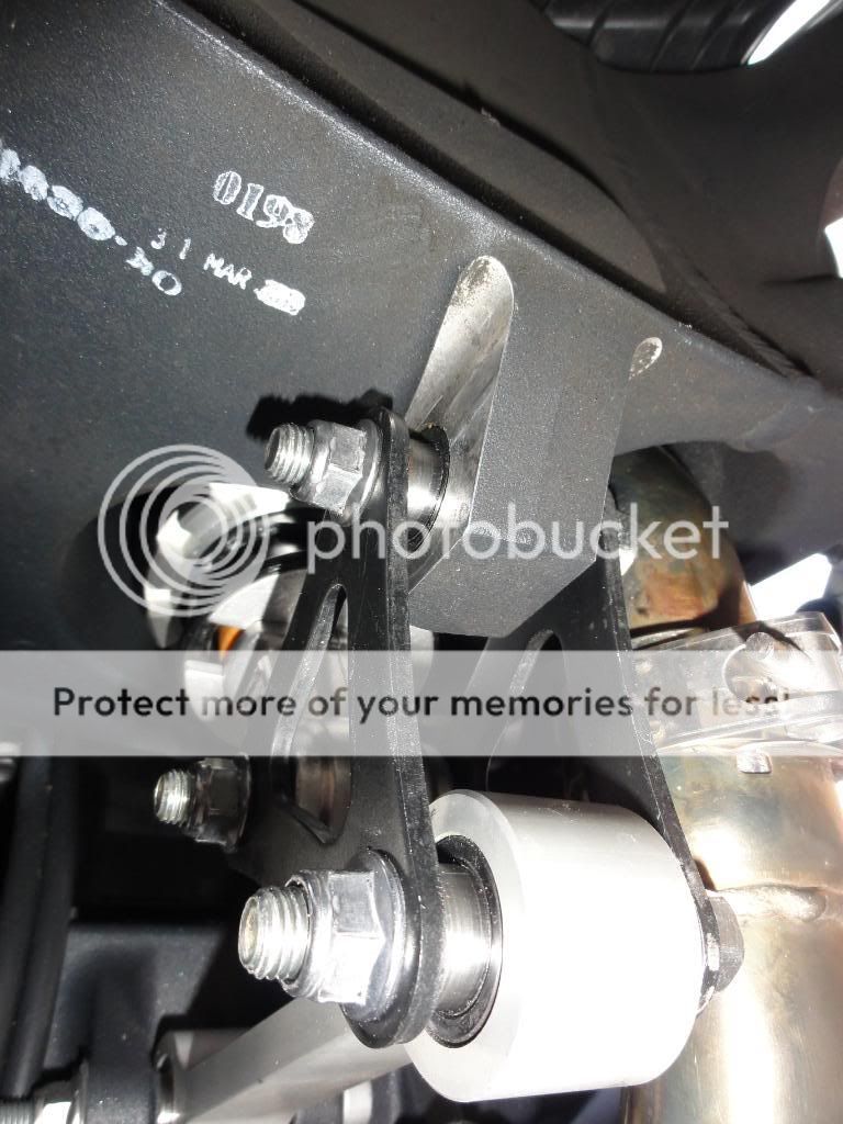

What you are seeing there is the shock mount bushing. The triangle plates mount/butt up against the shock bushing (which the mounting bolt goes through), and the bushing is part of the lower mount.
There are no spacers used here though with the CBR600RR rear shock conversion because this lower mount on the new shock is what requires bushings elsewhere in the other triangle plate mounts. The CBR600RR rear shock mount bushing is wider at 39mm vs the 30mm width of the stock Street Triple bushing. So spacers are added to the other two triangle plate mounting points to compensate.
Good question though and it is better to be cautious/safe than sorry when it comes to this stuff!

It may look like there isn't a width difference between the bushing and the lower section of the mount (the pictures are at angles that make it hard to discern) but there is; I would say around 1mm difference on each side.
Before I put the CBR600RR shock on I measured the bushing widths with a digital caliper and remember the bushing mounting surface definately being above the rest of the mount section. I didn't measure the mount section at the time though. As long as there is no binding or contact outside of the bushing then less or more free play (to a point) won't matter.
I'll see if I can get a good picture tomorrow showing the clearance that the CBR600RR shock has with the triangle plates' surface. :cool:
#26 ·
All the clamping force should be on the sleve inside the bushings. As long as the shock body is not being squished in the plates you are good to go.

I just needed to remove the footrests... :thumbup:
This gives me enough room to get the C spanner in and connected to the adjuster.
Tried positions 1 to five, settled on 3.
Everything is working just fine, the handling is much improved over the stock Triumph shock.
I rate this shock mod right up there with the 1050 throttle tube one.
Cheap, easy and effective.... :nod:
