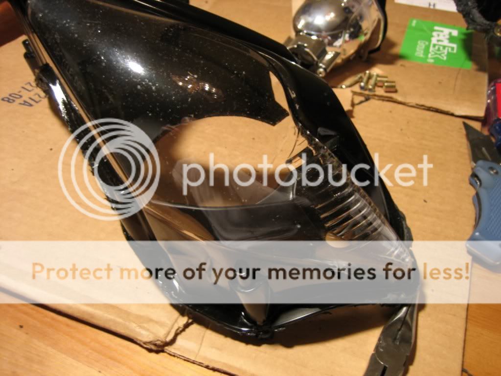

I have one corner opened but it's all warped to shit because I was prying at it with the flat head screw driver...

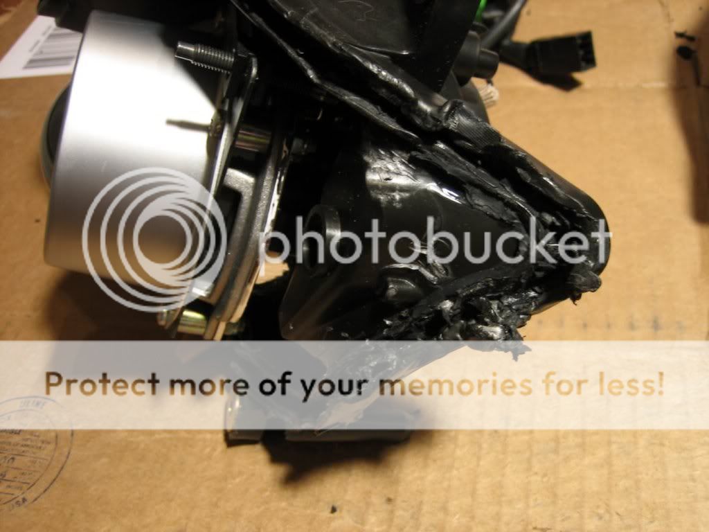

All I can say is these headlights can suck a dick.

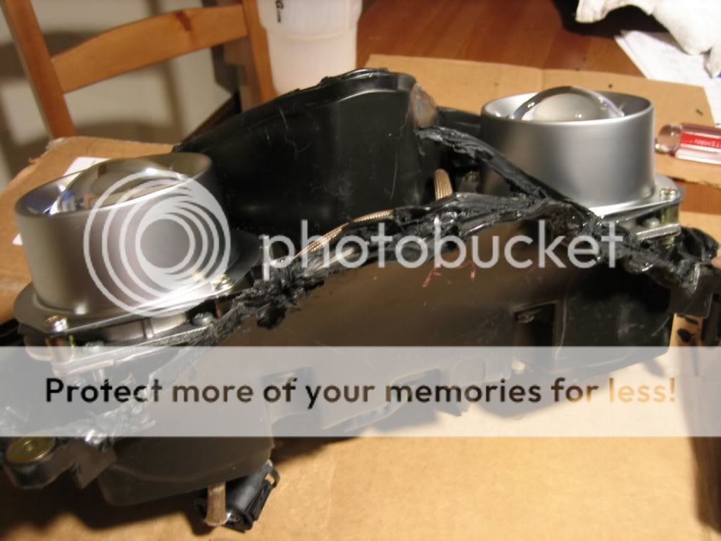

I tried oven with combination of heatgun and the only thing that is happening is that it's warping the outer black plastic shell.. I have one corner out but other than that it's useless...
I've never been so frustrated with something. I honestly think this is impossible to do with out destroying the shell.
I would have loved to paint the damn silver pieces black and the projectors gold... Looks like this isn't happening at all now...

after reading about this mod, i directly went to the g-rodge and opened up the front of my daytona, to cool to pass up i thought. three horrible day of not being able to ride later, and it's complete. red around the lens, and black every where else. BADASS!!!
Check it out YEAY!!!
ROFL

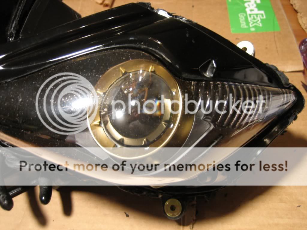

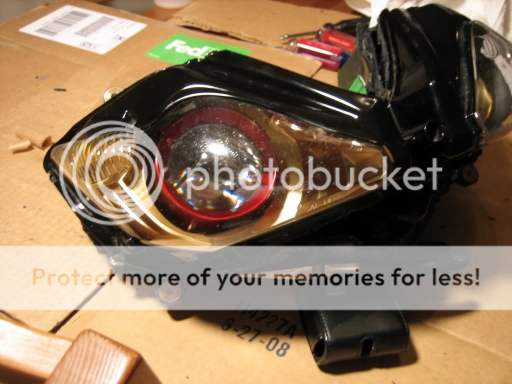

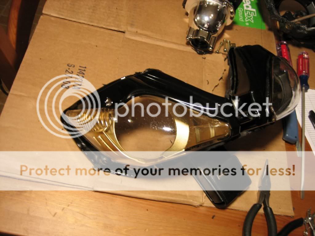

This is a joke because I was getting so frustrated via spending 5 hours on it that this is the result!!!(HACKED TO SHIT!) I figured might as well do the color combo's that I had in my mind.. gold sides and red housing, and black sides and gold housings..
I LOVE the gold sides... I think that might look good with a gold projector housing or most likely black projector housings.
I thought I would like the black sides with gold projector housings but it doesn't POP like I wanted it to...
Gold side pieces
Black side pieces
Gold sides with red projector housings
Black sides with gold projector housings

Seriously how much and this may seem rude (but please please please don't take it that way) can you ensure that the housing is not going to get fubared... etc. IE: My pictures above. I have no issues putting the housings together as long as they mate up but I don't want to botch anything.
I was just so fucking frustrated with the above and it taking over 5+ hours that I started ripping shit apart on the headlights........ This is NOTHING like my s2000 reto on my cars lights at all...
I thought at the time THAT was hard like probably a 7 out of 10...
This is a fucking 18 out of 10 via breaking the headlamps apart.

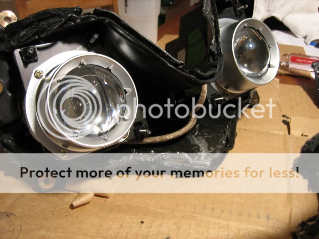

its just really time consuming. i got mine apart just ended up taking 2.5 hrs over 2 days of working on them. once u get a spot open stick golf tees in the opening and that way when u stick them back in the oven to reheat it does go back together. just get a buddy over and a couple flat head screwdrivers and work at it.
i had zero problems with the wires and zero alignment issues. :grin:
