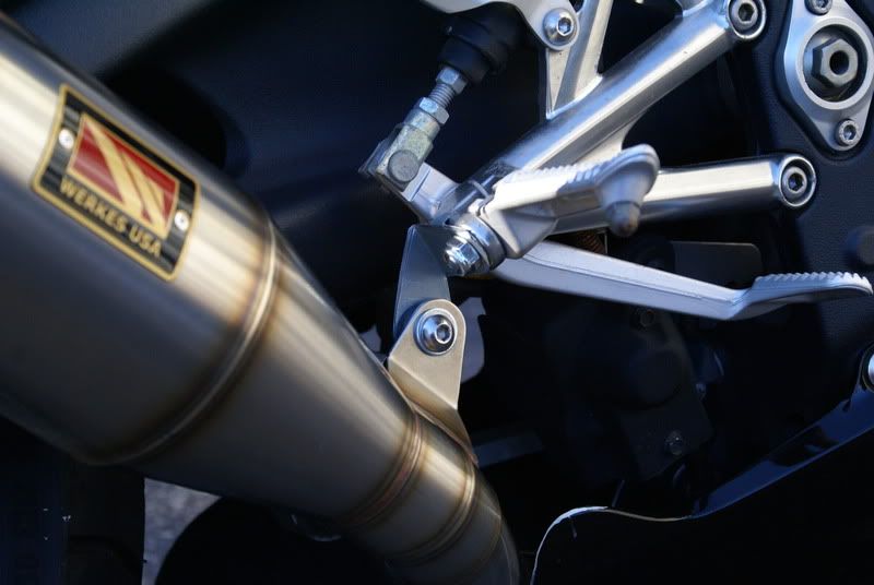

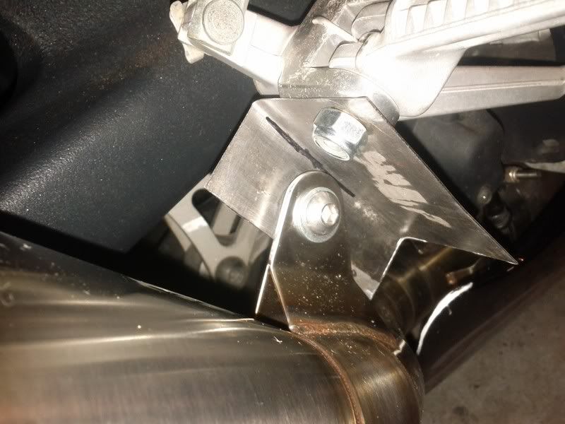

1) The pipe has two hangers, one underneath the frame and another that mounts to the rearset. The mount underneath the frame is shared between the Daytona and the STriple. The rearsets however are not. I made a simple bracket out of a sheet of aluminum.
I first got the bolt hole measurements on a large piece of flat stock that I bent at a 90* angle.
A 5/8" bit is perfect for the lower hole (the one that has a rubber bushing on it). First, get the bolt hole drilled for the lower hole, installed the bushing, then get the rearset bolt hole drilled. That way you get the proper space for the bushing.
Once I had the holes in the proper spot, I cut out the bracket. It took me about 20 minutes total to build this bracket. Its not the prettiest but it works.

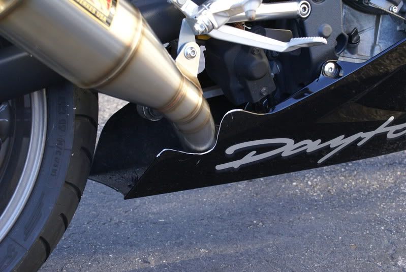

2) The next step could be a deal breaker for most. On the Daytona, the body work gets in the way so trimming is required. I was sweating bullets on this portion. Remember, cut in small increments. You can keep removing material, you cant add it back on (easily).
I have heat tape on the inside of the body work so it should reflect most of the heat from the pipe. I plan on getting some touch up paint for the edges.
Otherwise, the install went pretty smoothly. I ended up removing the header completely from the bike to cut the rear bend off (sorry, no pics), but you should be able to do it on the bike. Be sure to grind the rear weld on the catalytic converter pretty well otherwise the pipe wont be able to slip over it. I used an angle grinder for that one.

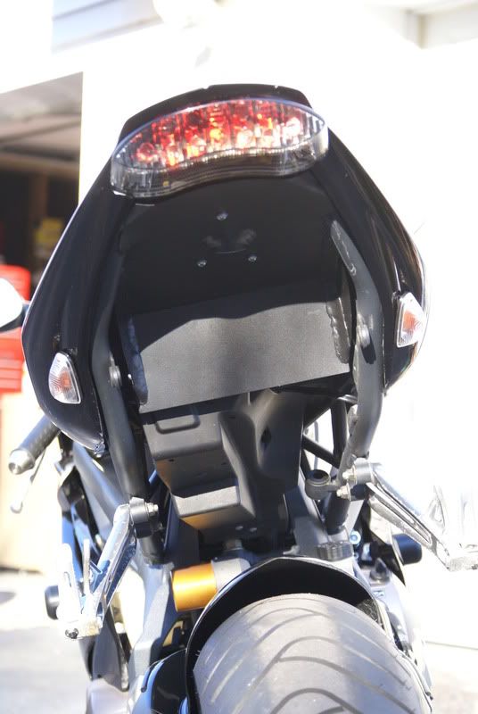

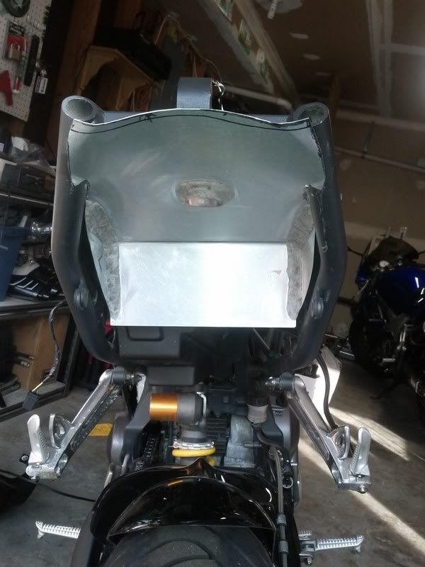

For the Daytona, you also need to figure out a license plate mount. I decided to make one out of thin gauge aluminum and enclosed most of the undertail.
Its made out of three pieces, the top/rear and two sides. I riveted them together then used JB Weld putty on the seams in hopes that I could smooth it out well enough (didnt work as planned). I also flushed in an LED license plate light and mounted the turn signals to the rear cowl. Im not 100% happy with the undertail so Ill most likely be making another out of fiberglass later this year. I used black Plasti-Dip paint on it. And yes, I did scratch the hell out of my subframe - I might be getting that powdercoated anyway.

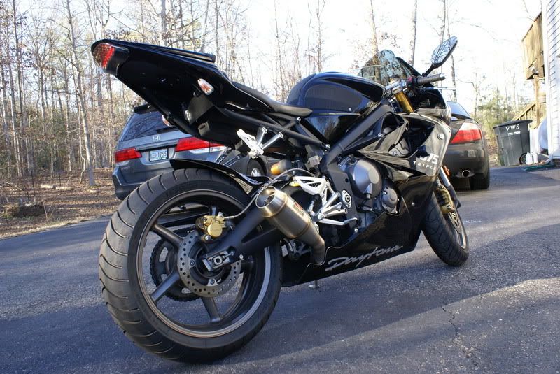

All in all, the finished product looks something like this.
The pipe is pretty loud, but it sounds beautiful. If it werent so windy today I would have taken a video of it. CW is in the process of making a baffle for it, which I am looking forward to.
This pipe removes about 15lbs from the bike. I haven't taken it out yet as its not legal at the moment, but from the looks of it, my foot does not contact the pipe at any time.
