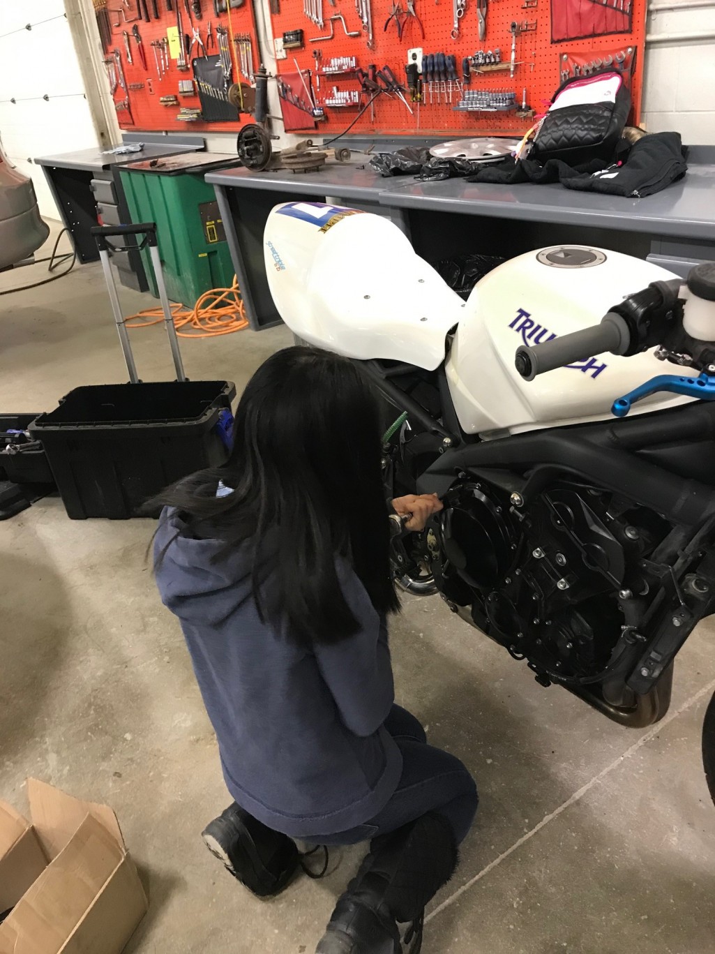

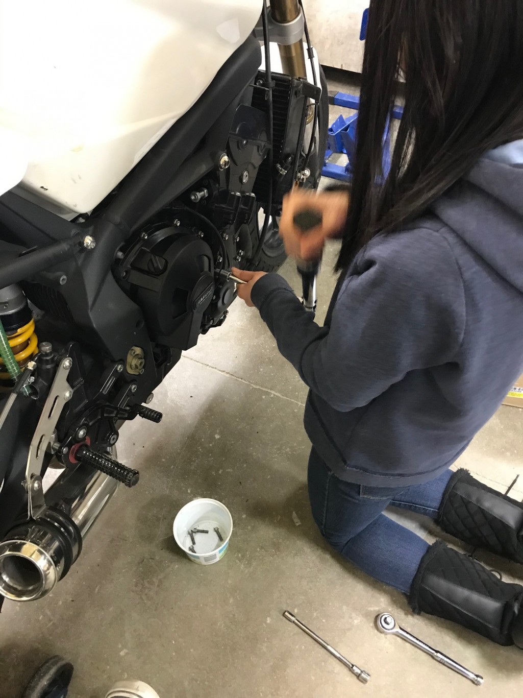

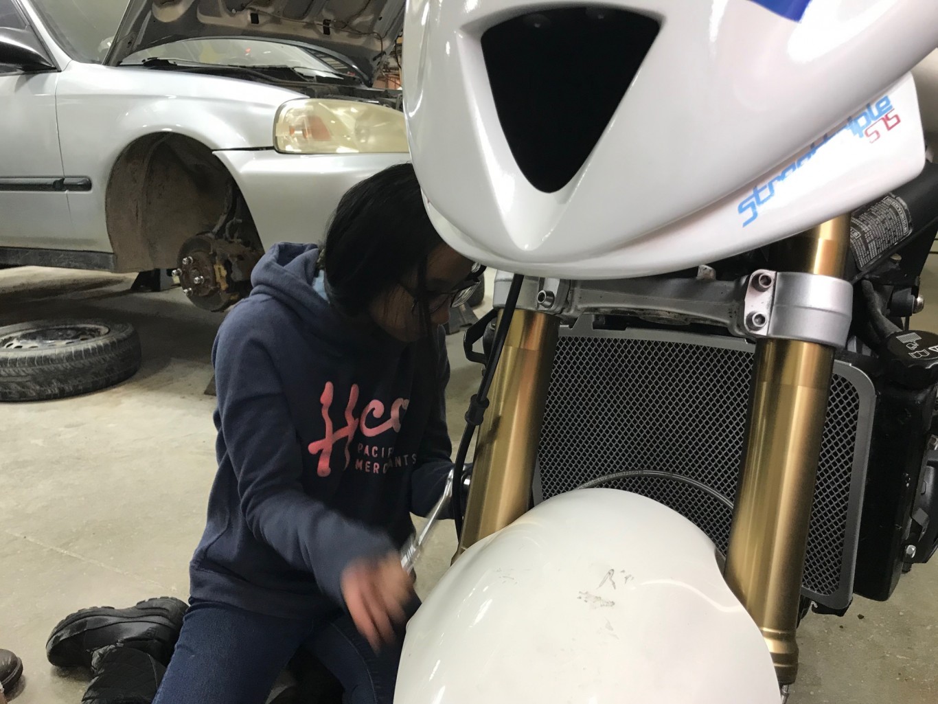

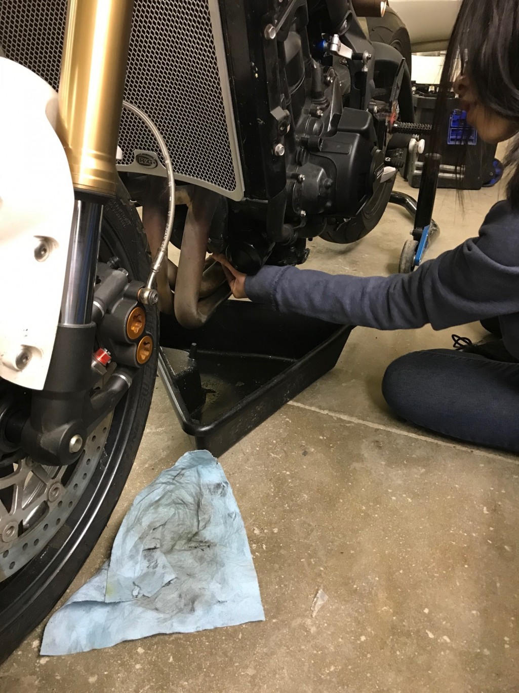

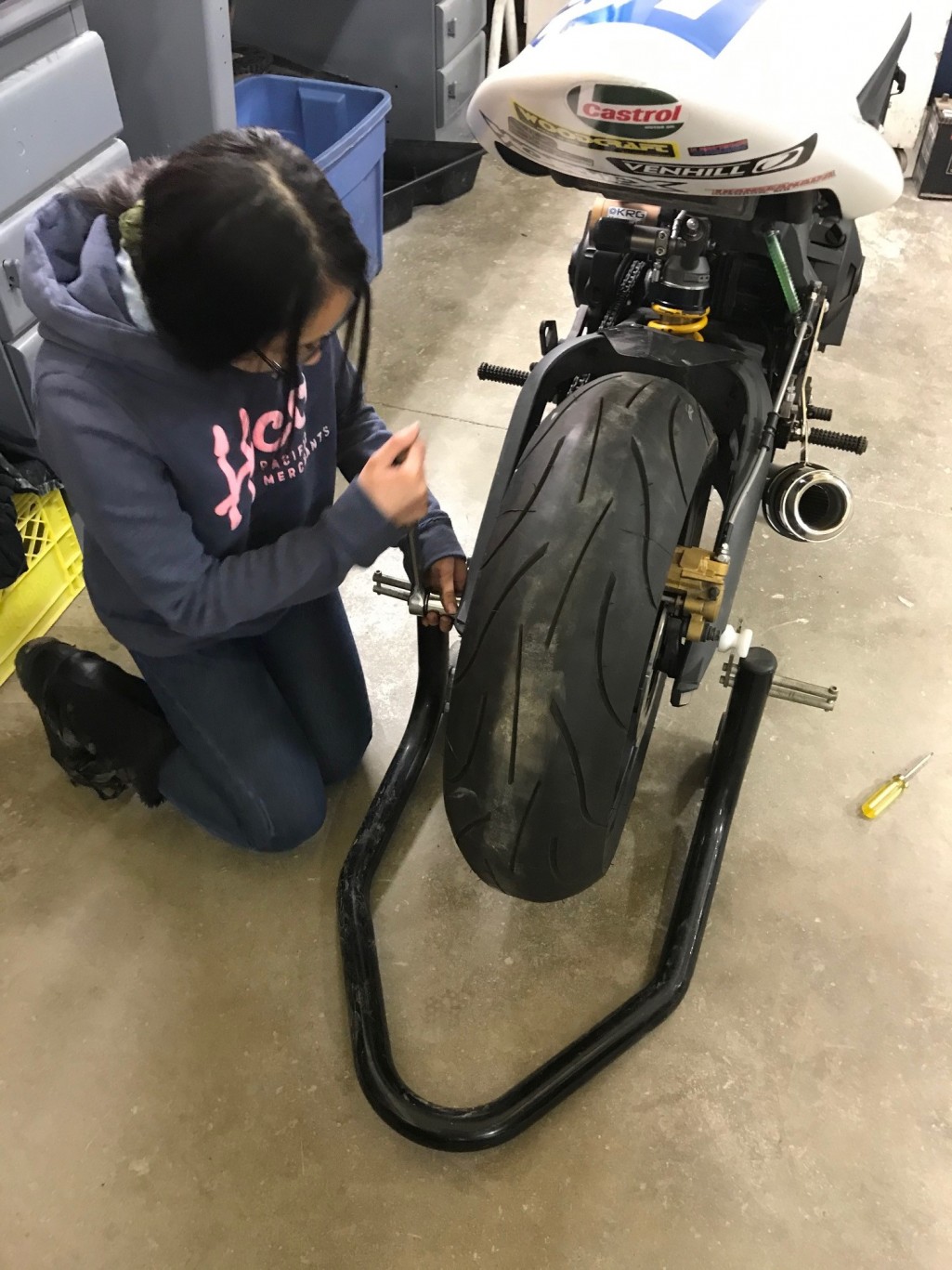

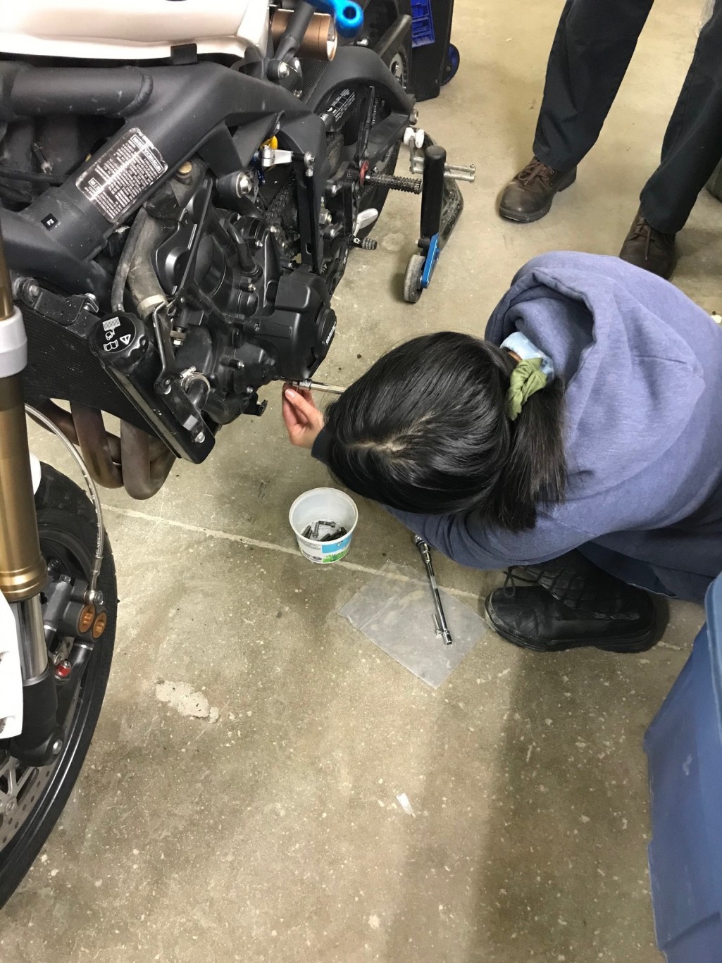

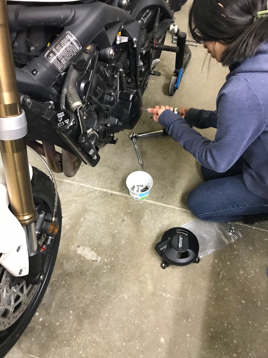

Some more pics from the Bike Club session last night. Working in tight spaces... changed the plugs, swapped the air filter for a race version, and replaced the water drain bolt with a drilled one for safety wire. Plugs looked ok, but you might as well change them as they could be original to a 32,000 km bike... spark plug boots were pretty stubborn, so we reinstalled them with some lithium grease. Should help keep any dirt from slipping past and falling in the engine the next time the plugs are swapped.
