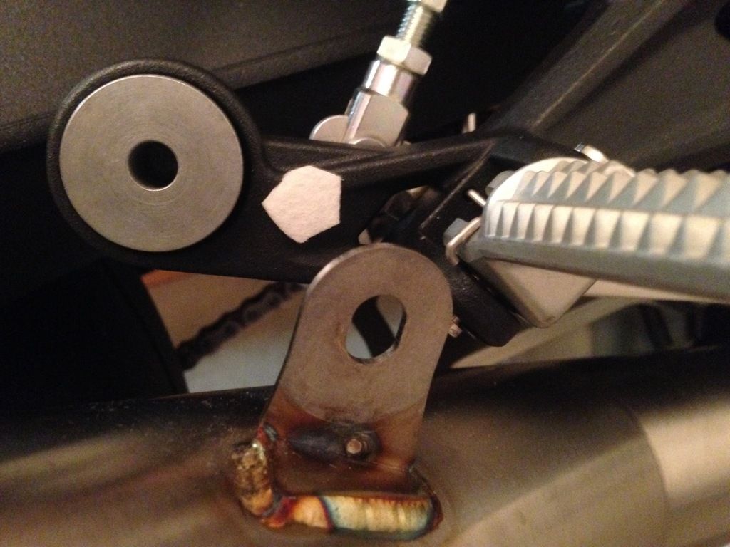

I've attached the rearsets and have mounted the exhaust, but I'm stuck at the point where I need to connect the exhaust to the rearsets. Have purchased an aluminum bar and am thinking of fabricating an extension bracket to connect the two, but wanting to see what others have done since I'm sure there are better ideas out there.

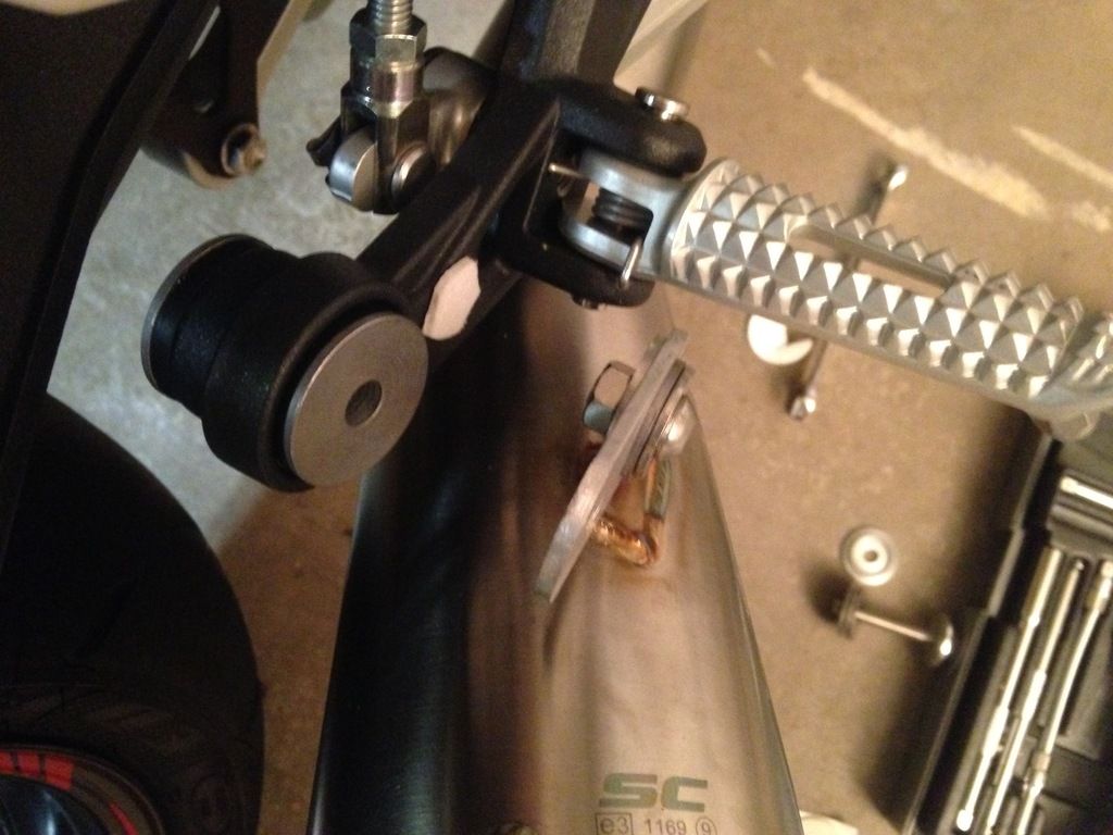

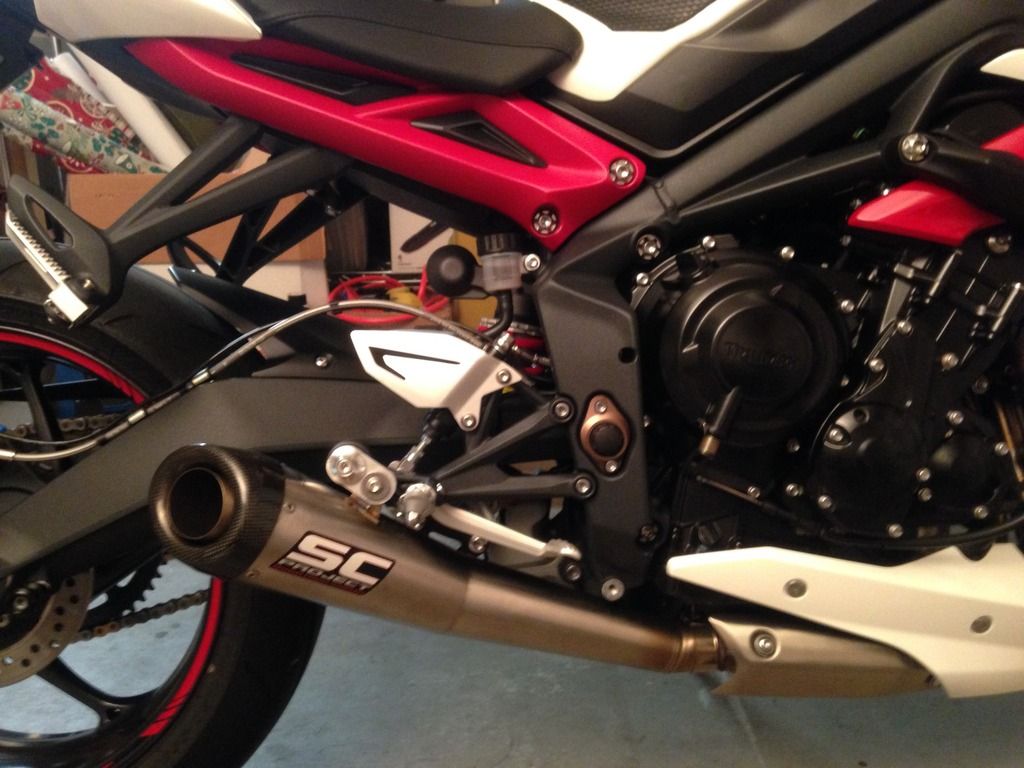

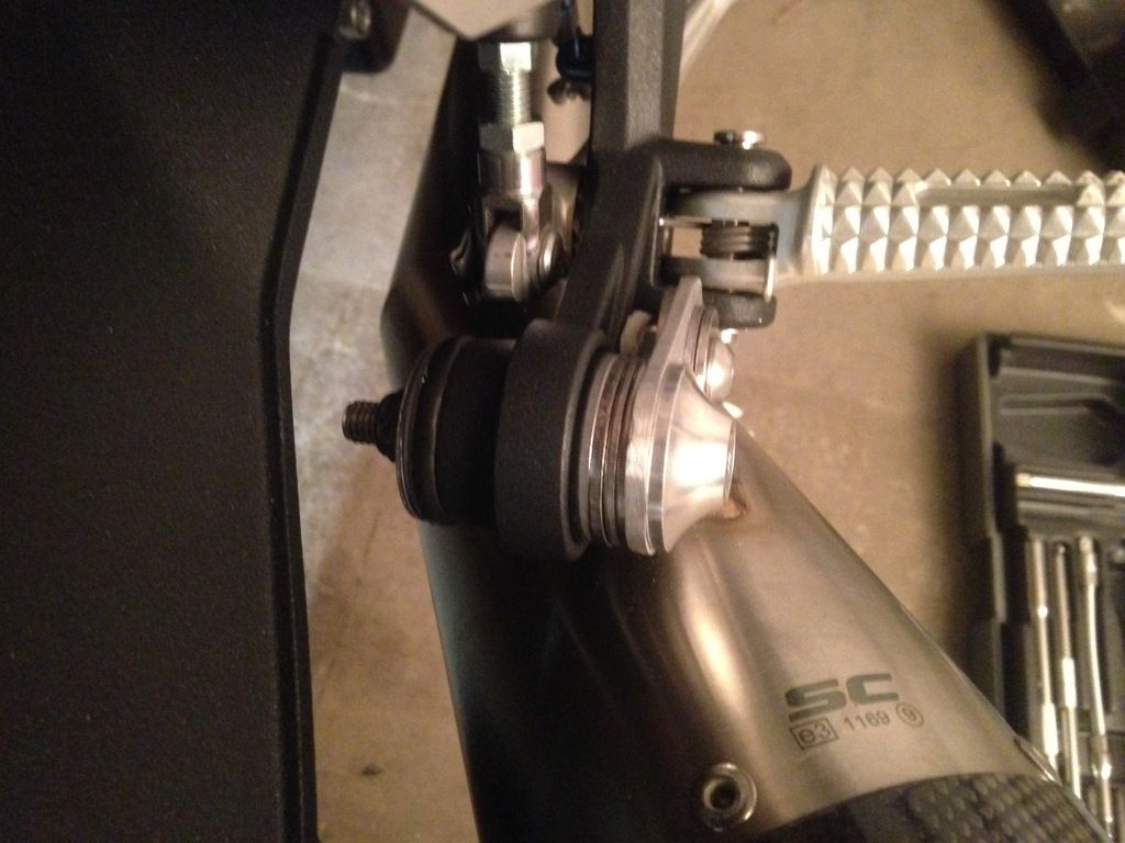

post #2 of 11 Old 02-10-16, 13:24 Thread Starter
Rookie28
Rookie28's Avatar
Join Date: Dec 2015
Posts: 113
Thanks: 100
Thanked 23 Times in 20 Posts
Cool Voila!

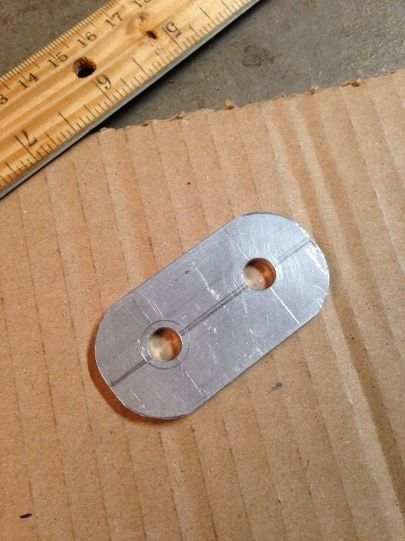

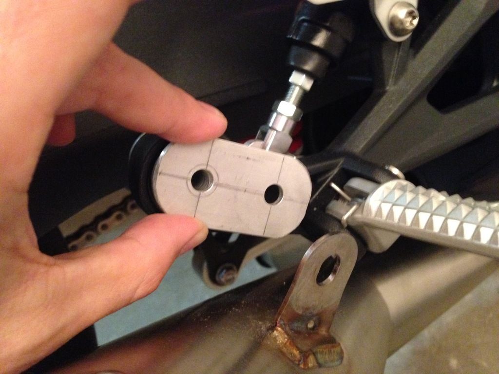

I've gone ahead and made a bracket to link the exhaust and the Daytona rearsets. Here are some pics. Hopefully they'll be useful to someone in the future.
Made 2 3/8" x 1 1/4" aluminum bracket with 8mm holes spaced out 5/8" apart, using a dremel tool and a power drill.

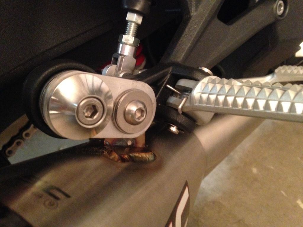

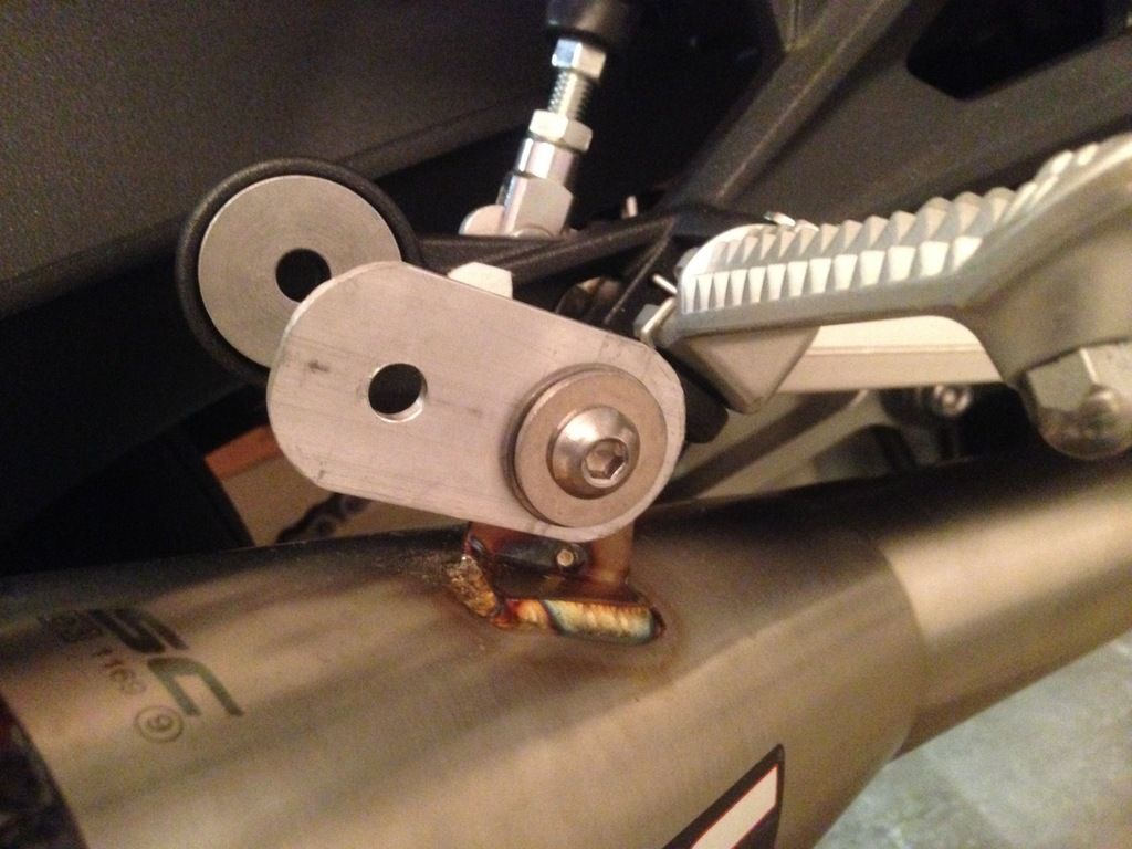

When placing a nut on the inner side of the makeshift bracket, the nut makes contact with the rearset and can scratch it, so I found a piece of sticky padding that is used on the bottom of furniture and placed a small piece where the metal would rub. I used an M8 1.25 x 16 bolt to connect the bracket to the exhaust.
Due to the space that the nut takes up, I had to add multiple washers to the portion that connects the bracket to the rearset so they would match up evenly.

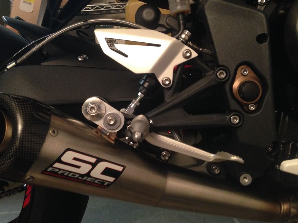

And the finished product! Not beautiful, but it gets the job done

I'm a little confused. Did the SC Projects exhaust not come with enough, or proper, hangers?
The SC Project will bolt right onto the Striple rearsets, he has Daytona rearsets for his bike which have a slightly different exhaust mount location.
