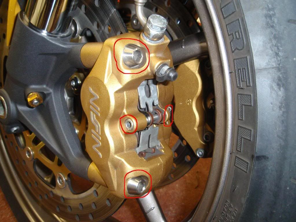

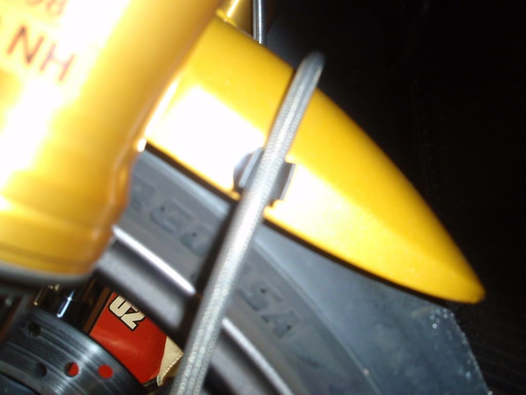

1. Start by breaking the three circled bolts loose, don't turn the 5mm much, there is a clip on the back of it (also circled)
2. Carefully take the brake line(s) out of the plastic clip on the fender
3. Completely remove the two larger bolts holding the caliper on and carefully work the caliper off the rotor and out

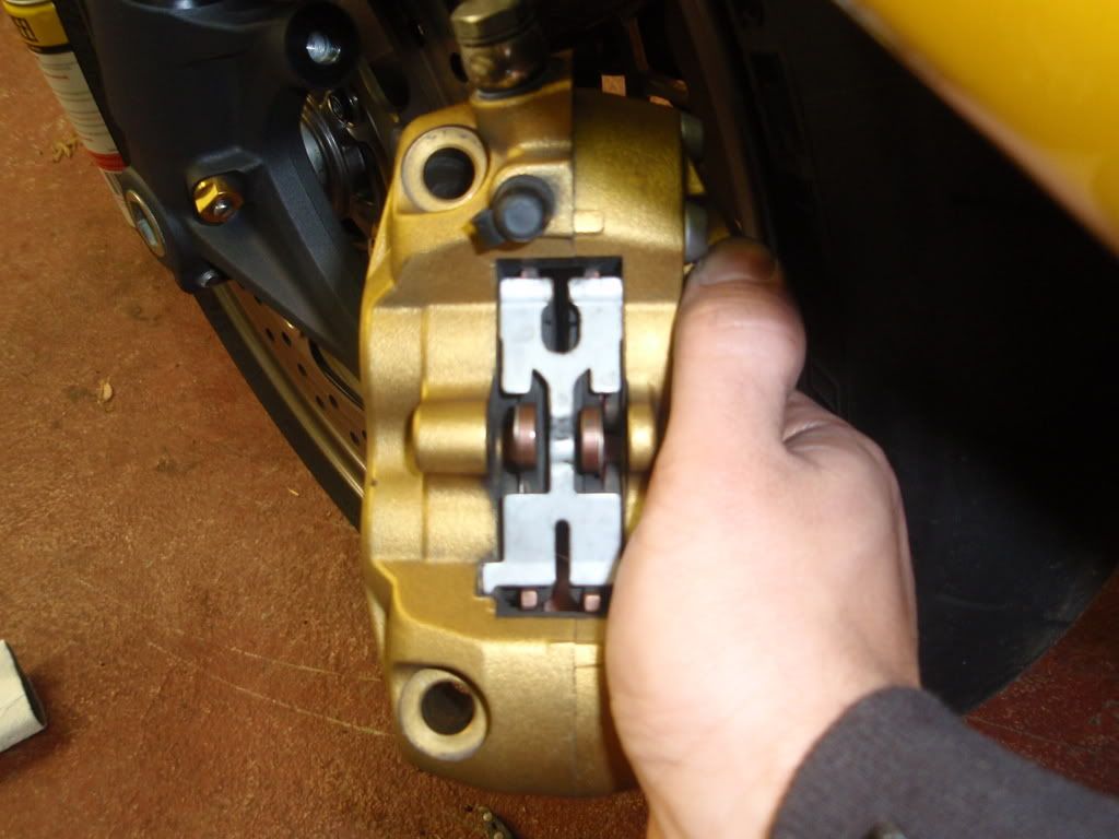

4. Take the clip off the end of the remaining bolt and unscrew that.
The metal clip under it will now fall out and the pads are free
5. I marked the pads left and right so I could put them back in where they came out since I was not replacing them with new ones

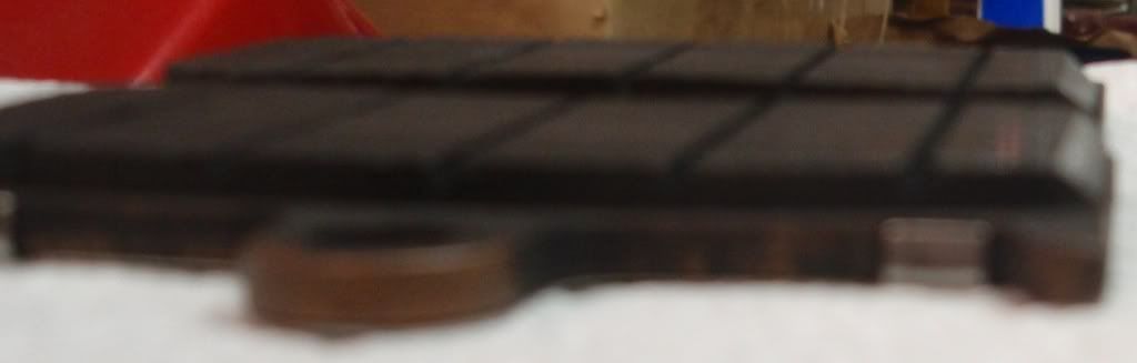

6. Grind down the leading edge of the pad (bottom) to a 45ish degree angle. I was fortunate enough to have a power stone grinder, but a file will git 'er done fine

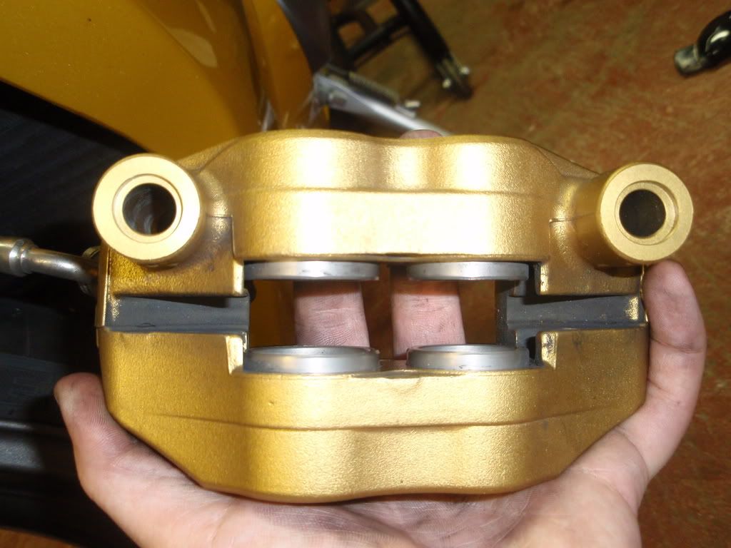

8. *If replacing the pads you will need to compress the pistons or you will not get the pads to clear the rotor when replacing the caliper*

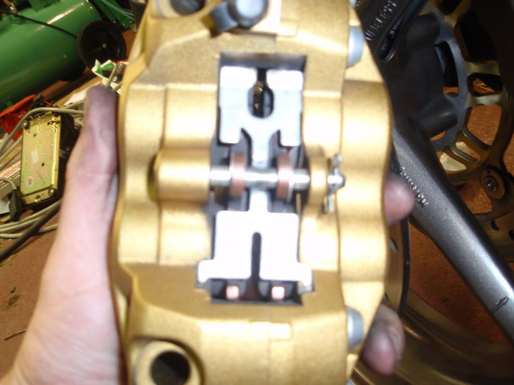

9. Apply a small amount (too much might make the grease wet and runny, not what you want on your pads) of high temp grease (they make stuff specifically for this job, but I used Mobil 1 synthetic high temp) to the piston rings, and the back of the pads where they touch
9. Seat the pads back in the calipers where they will be when resting
10. Replace the clip that came from under the bolt
11. Work the bolt through the first pad, over the clip, through the second pad and then the far hole on the caliper. Make sure the pads are still in the seated position after this is done, they are difficult to move once the bolt is in
12. Tighten that bolt hand tight and replace the safety clip

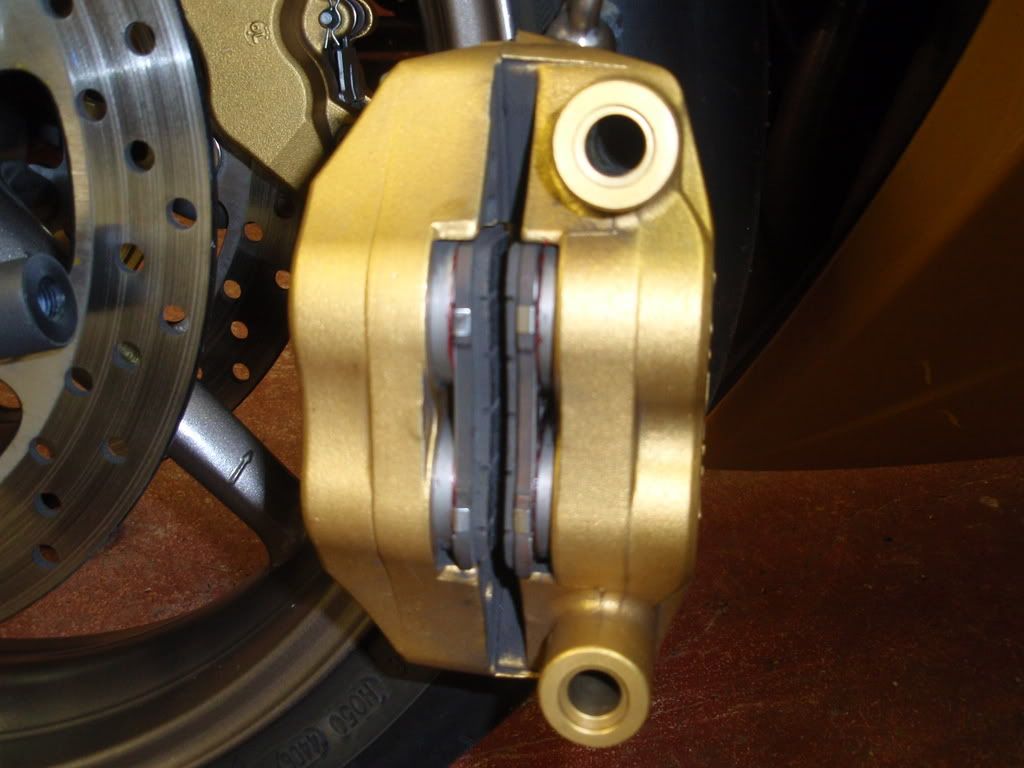

13. Put the caliper back in place, work the two large bolts in and snug them each down, then tighten to spec - 35 Nm
14. Tighten smaller bolt to spec
15. Replace brake line(s) in the plastic clip in the front fender
