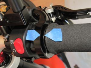

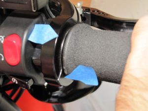

Forgive me if I call foul but even the 1050 throttle tube is between 1/4 and 1/2 turn when on the Street Triple let alone 1/5 ....
Easy to clear up though, the two have very different profiles at the cable mount and can be told apart visually so why don't you slip the throttle tube off and post a picture of the cable mount end, head on please
EDIT: Correction to my previous statement, just checked and with zero cable slack my throttle throw with the 1050 tube is right at 90* or 1/4 turn from resting position to WOT.
