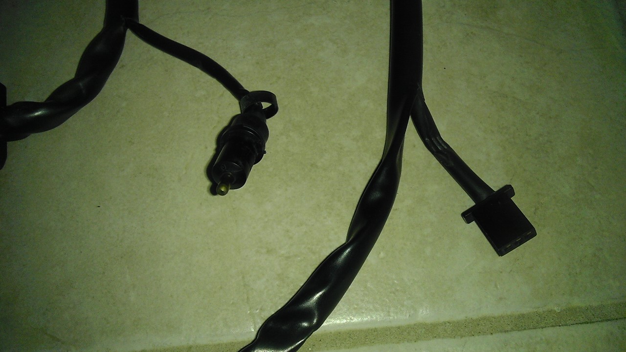

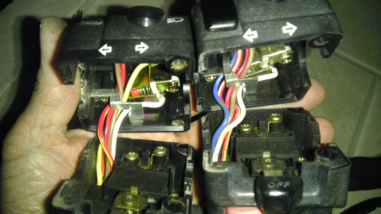

$215NZ vs. $400NZ… I dunno why people aren’t buying locally…
I got these off ebay.uk for £40 shipped to the States. It's off a 2005 955i. Now I just need help wiring the thing. It's plug but not play. The bike will not start with it on and it only seems to work with the high beam. The low beam and parking lights stay on when the bike is on even thought the switch is in the off position. And I have no clue where the UK piggy tail would even wire to on the U.S. spec bikes. Any help would be much appreciated.

Your controls+plugs look the same as the ones I bought, You have to move the clutch switch over to the new controls, and ditch the piggy back. I posted the original wiring schematic here http://www.triumph675.net/forum/showthread.php?t=63957, my memory is fuzzy on the new wiring to accommodate turning off the lights and Im away from my bike atm...
Update: By default the lights would be on even with the controls not plugged in because the headlight wiring bypasses the switch, I had to cut one of the wires going to the headlights and wire it through the controls. Have a look at the haynes manual for a full schematic.
